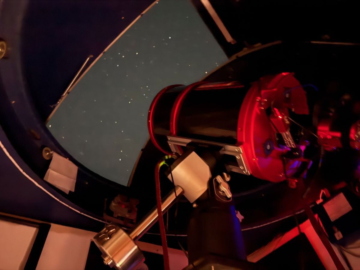

Overall, I’m impressed with the telescope itself. The optics appear to be very good, the mechanical build quality is excellent, and everything feels well thought out. From an overall usability standpoint, it’s been a very positive experience. I haven’t touched the collimation yet, and straight out of the box I’d say it was surprisingly good. I was able to lift it onto my pier myself that is holding the RST-300 mount without much problem (shoulder height lift).

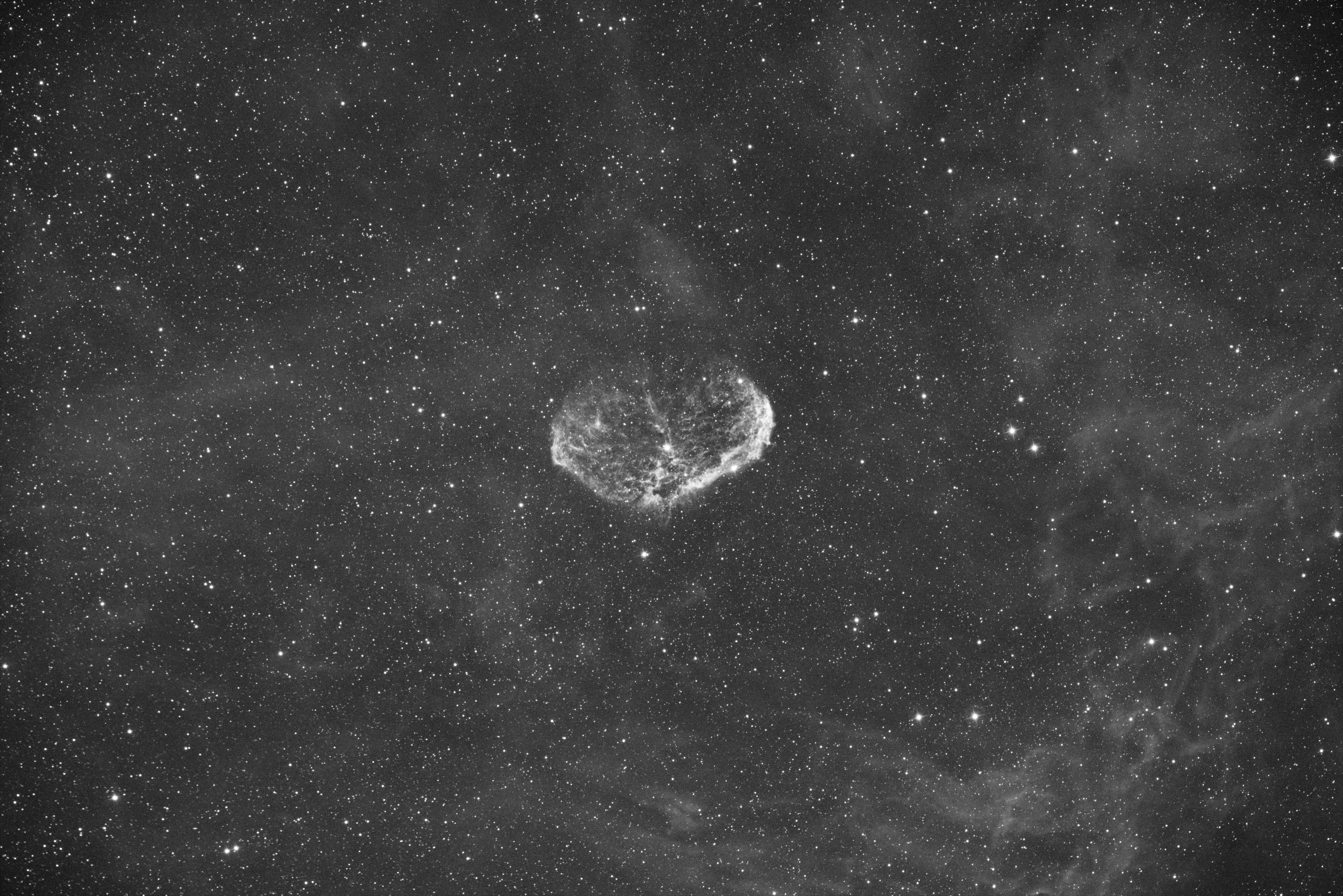

Attached is a single raw sub captured with the SCA-310 and the ASI6200MM using standard ZWO filters. Those filters will eventually be replaced because I’ve seen haloing from them in the past, but they immediately eliminated the haze issue I was fighting. That alone was enough to convince me I was finally looking in the right place. (it's compressed of course for CN transport)
Hopefully this helps someone before they spend several nights chasing a problem that isn’t the telescope or the camera at all.
Posted 7/11/2026 9:36:56 AM CST
Here is the full resolution of the single sub -still JPG but much higher quality:
