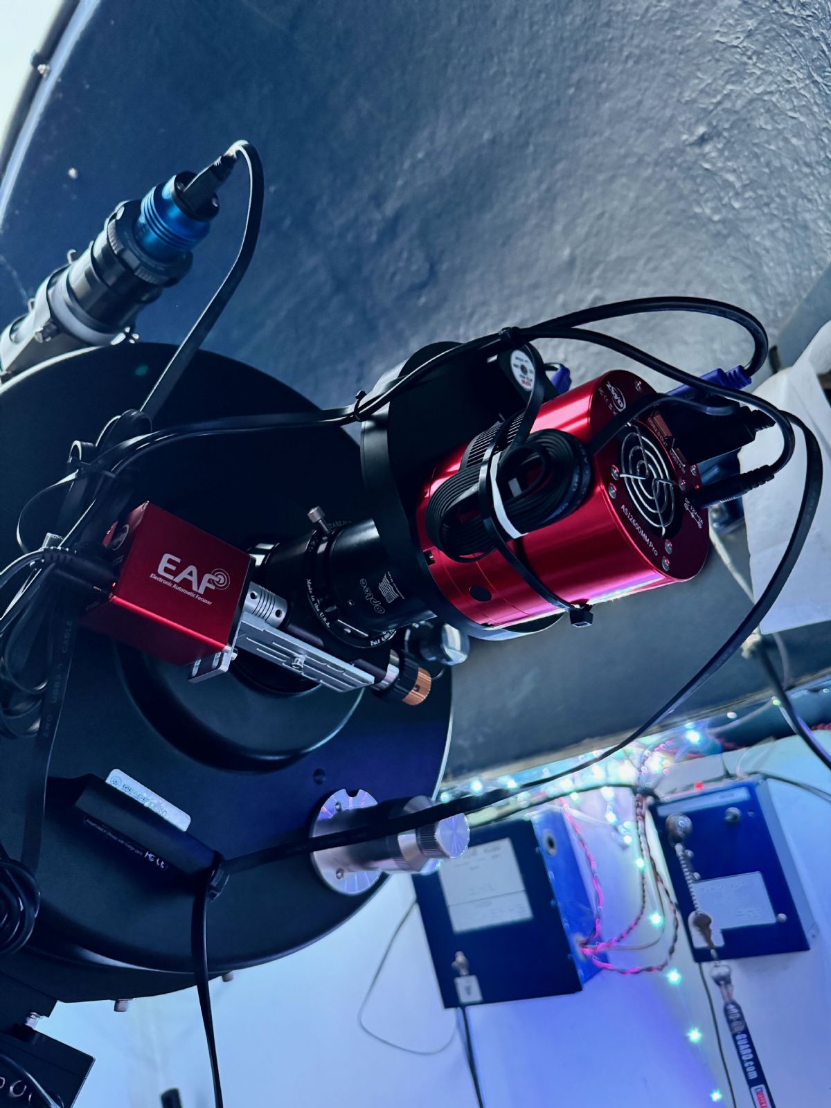

I have the 14" ACF F/8 and use the Feathertouch focuser at the back with a ZWO EAF for focusing. They are spendy but worth it.
https://www.starlightinstruments.com
The rough focus knob on the SCT is used for getting that monster mirror set, but once I get it in the correct focus zone, I let the FeatherTouch focus everything remotely via the EAF and never move the mirror.
I am attaching a photo of my rig. I was using the Optec reducer at the time this was taken, but I have since taken it off because I couldn't achieve round stars with it on.
In the photo, the train is like this:
Visual back replaced with Featherlight -> Optec 2" barrel reducer, straight into the filter wheel threads

Posted 11/30/2024 10:19:01 AM CST
It is the Starlight Instruments Feather Touch 'Shorty' dual-speed focuser:
https://www.starlightinstruments.com/product/ftf2008bcr-feather-touch-rotatable-2-0-diameter-dual-speed-0-8-draw-tube-travel-brake-and-compression-ring-aka-shorty/
Make sure to order the one that screws directly to the back of the Meade OTA (visual back comes off).
