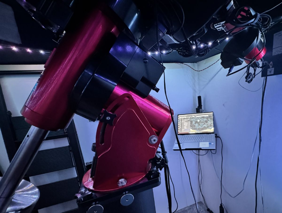

I have read several posts on Software Bisque's website, along with others on cloudy nights, about how to get the ASIAir to work with a Software Bisque mount.
I have the SB MX+ and I've got good news - sort of...
It will work. You can connect to the mount from the ASIAir, but there are a few oddities you need to be aware of.
How to connect the ASIAir to a Software Bisque mount
First - yes, you must have The Sky X running and connected to your mount, and the mount needs to be homed. The ASIAir has no idea what that means.
Second - you need to have the TCP server of The Sky X running.
Thirdly - you will need to connect the ASIAir to Software Bisque + TCP Server
ASIAir and MX+ Software Bisque mount connection oddities
What doesn't work
It will only goto if you disconnect the mount and reconnect the mount each time you slew inside of the ASIAir. Oddly enough, sometimes it will accept two slews.
Example: Connect mount, slew to M13. There is no small adjustments to correct the frame. Now slew to Andromeda (M31), it will time out. Disconnect the mount, count to 3, reconnect the mount, you can go to the next object.
You have to turn off the center on slew option inside the Air - it won't work.
There are no mount adjustments you can do and since auto-centering won't work, WYSIWYG (What You See Is What You Get)! (use The Sky X tools)
Polar Alignment will not work. It connects and does resolve that first shot - but when rotating the mount 60 degrees, it slews it just a hair faster than the satellite tracking rate. I have waited 20 minutes before to let it finish and it never does. (use drift method or manually align / use internal tools from TSX)
Guiding does not work either. (must use The Sky X guiding)
